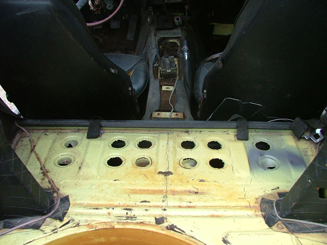

      -en image le pré-71, sans boite à outil derrière les sièges et sans trou derrière les custodes (badge 240z), hayon avec aération sous la vitre, dégivrage vertical etc... et sur cette coque on ne peut pas avoir de BV5 sans modification du trou de tunnel pour levier de vitesse.
      -puis les post-71, les plus répendues (surtout chez nous), avec les trappes à outils et l'aération derrière la custode avec un badge rond.

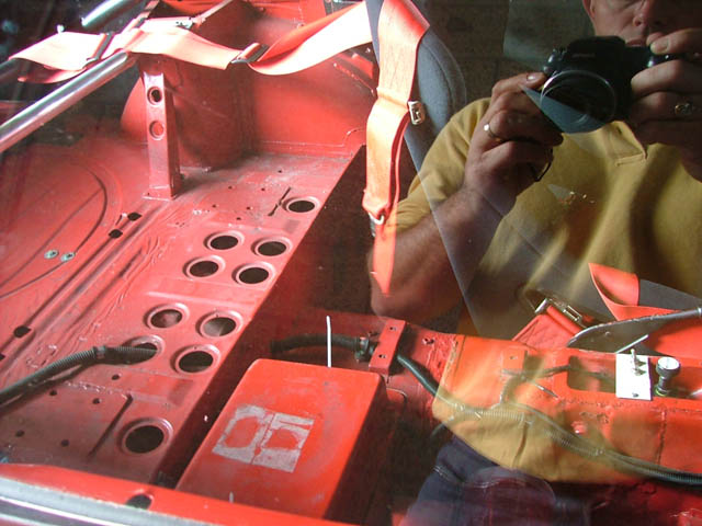

                As I've told you before ( I'm sure I have.... ) it's the 432-R's 'PZR' bodyshell / monocoque / unibody ( whatever you want to call 'Part Number One' ) that is the special one.
                The genuine early 'PZR' body was made up from some completely different pressings to all the other contemporary Z models. Certain sections of the body were pressed from thicker gauge steel than 'stock' ( especially the chassis members around the diff area ) and many of them were made from thinner gauge steel than 'stock' - including the roof, rear quarters and scuttle panels. The rear 'floor' of the body was made with a ribbed panel that eliminated the spare wheel well of the 'stock' bodies, in order to allow fitment of the 100 litre fuel tank, and extra bracing / mount points were included to support the extra weight of a full tank. There were literally hundreds of other differences, and that's before you even start to think about the lightweight panels and special parts that were hung onto the PZR 'shell......
                In comparison, the early '240Z' ( whatever that means ), Fairlady Z & Z-L, and Fairlady Z432 bodyshells were all very similar to eachother if you overlook the obvious differences between LHD and RHD configurations, and the parts that were bolted onto 'Part Number One'. You have to take into account the need to compare 'shells that were made in the same periods ( there were hundreds of updates / mods during production that applied to all models ) and the obvious market variant differences, of course.
                So - to sum up - the 'PZR' body stands apart from the all the others that were made during the same period.

                    L'auto de M Miroux, la voilà
                    ce n'est pas simplement une pré-71?
                    C'est qui en reflet dans la vitre? hi hi hi

                        La mienne est une 71 et j'ais des coffres derriere les sieges,pour la ramener a l'abri les millions des pov contribuables francais, une culasse E88 alors c'est pas bon?
                          si c'est bon, c'est une série 2 "post-71" qui a commencé vers le milieu d'année 71
                          E88, c'est normal
                          c'est ce qu'on appellerait un "milésime 72"
