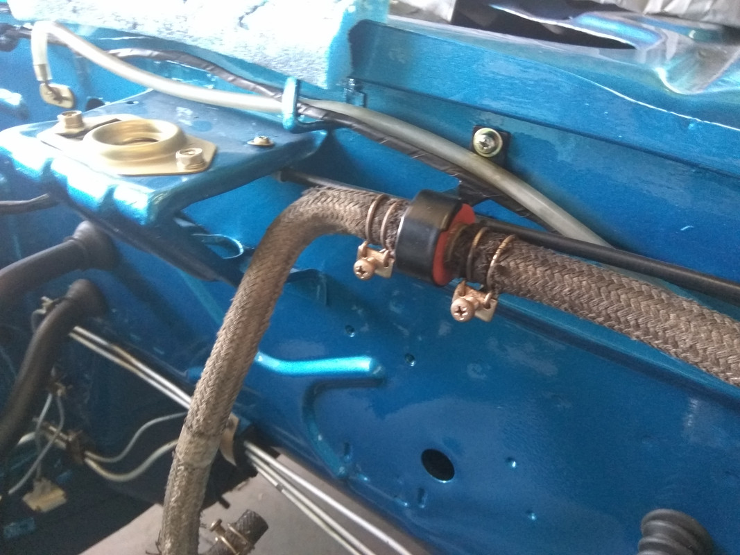

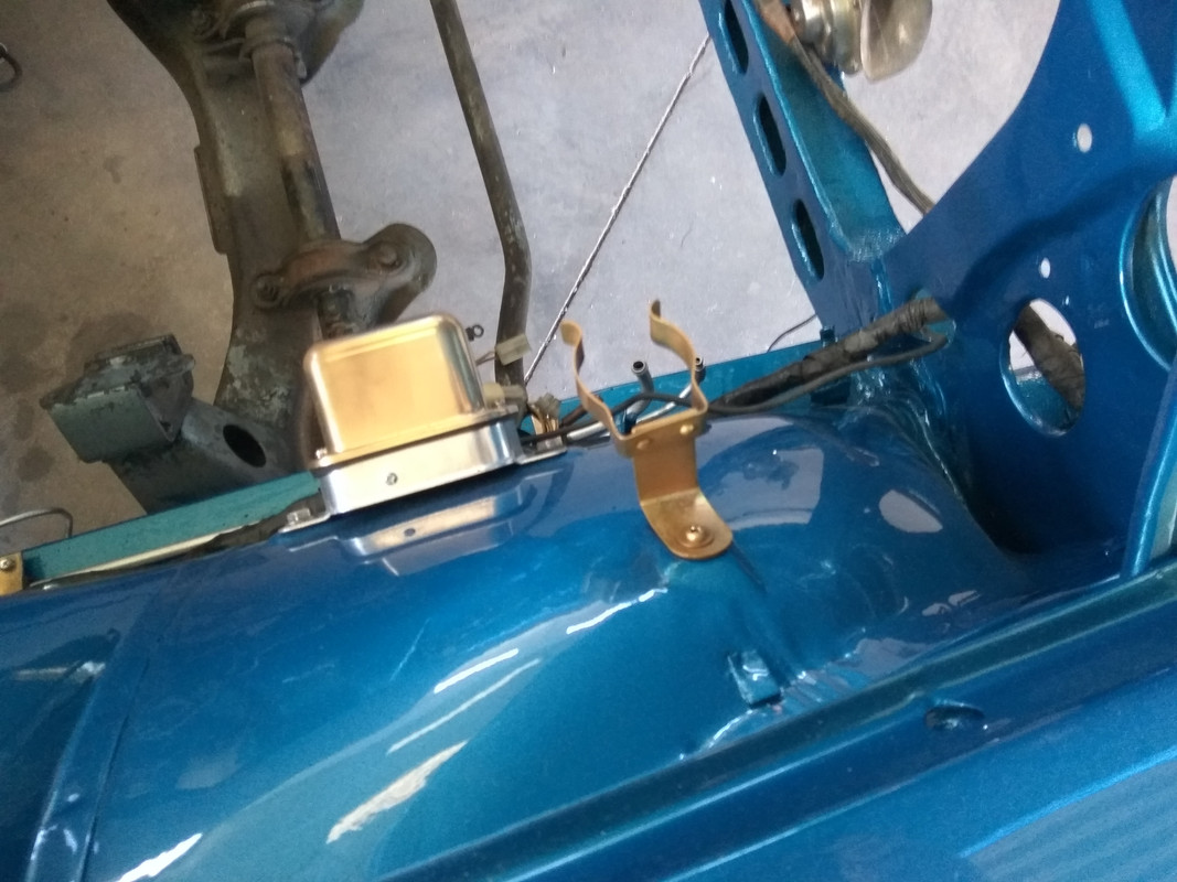

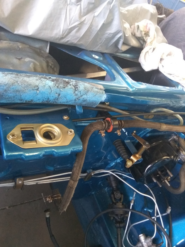

Plated and zinc parts…
The fuel filter stand is originaly painted black, but I’ll leave it zinc…it’s cleanerto the engine bay…I think!

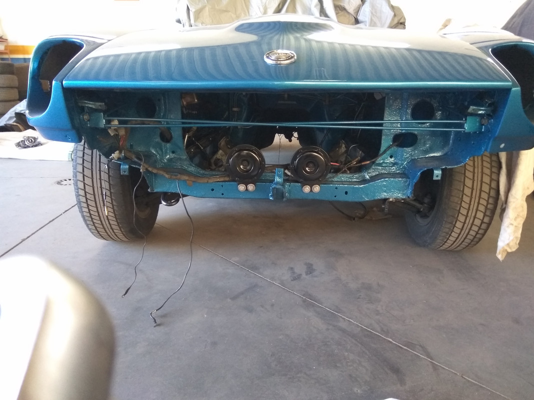

New horns…before there were the giant vintage bosh…

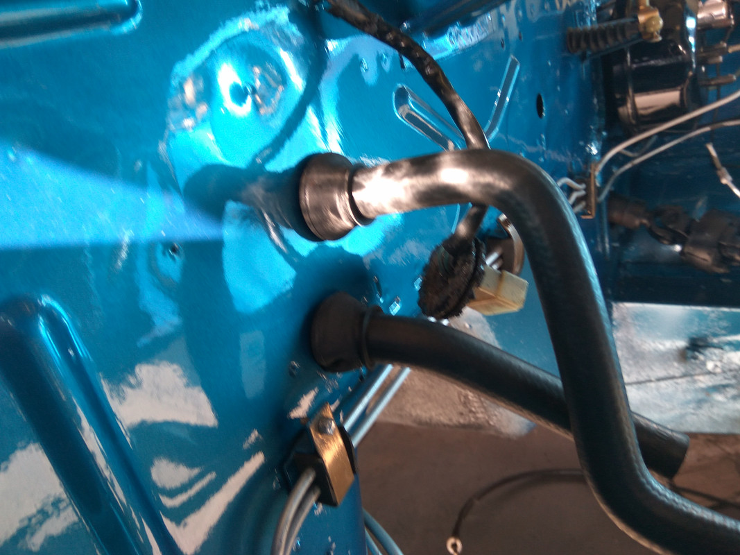

New heater grommets…

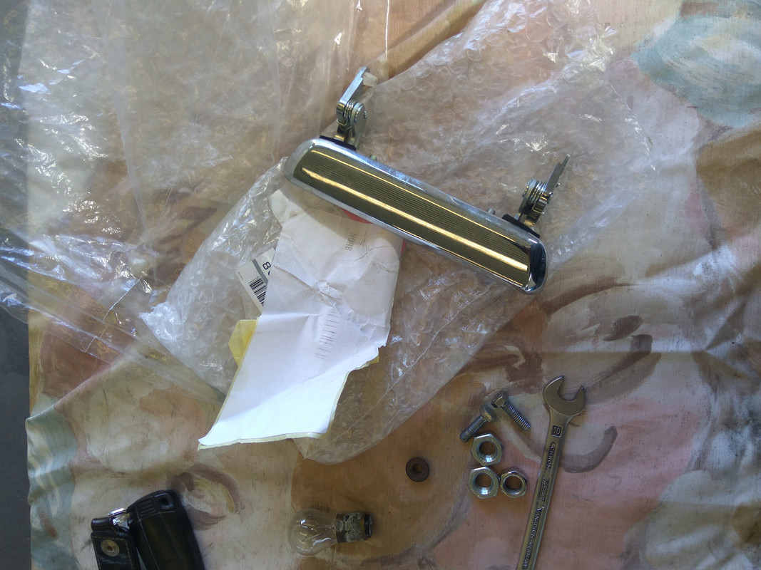

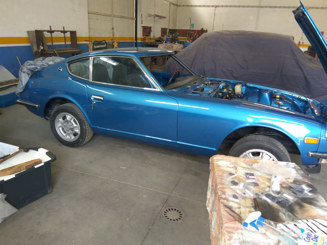

Installing the door. New key lockers, new door handles, glass elevators and the main lock. This last one borke down. I suspected before the resto, that it didn’t opened the door properly!
New hood handle...the previous one wasn’t original and didn’t match S30!
New rubbers for hood handle and km mark.

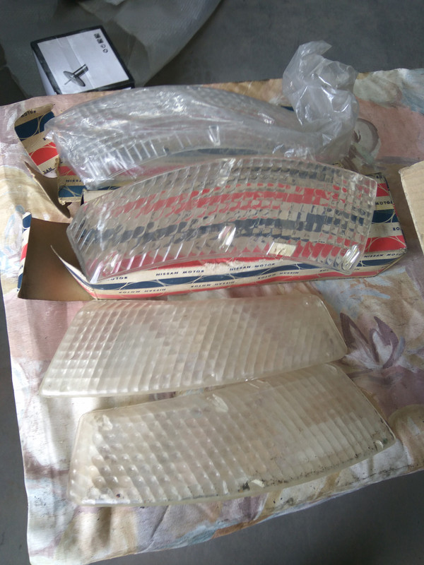

Cleaning and installing the side markers.
Installed..they fit very well!
And left side almost ready…

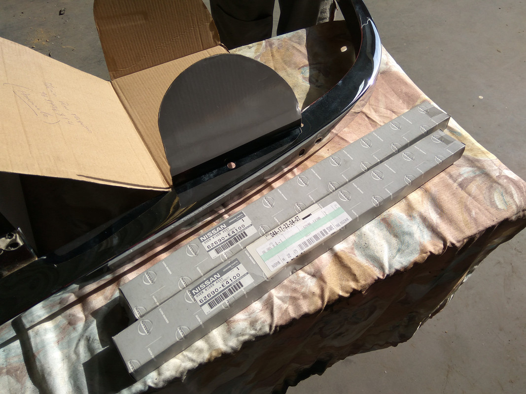

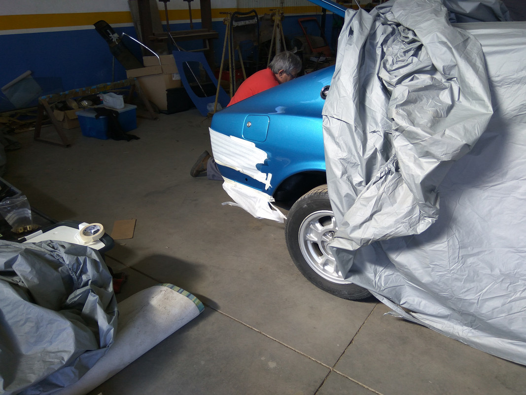

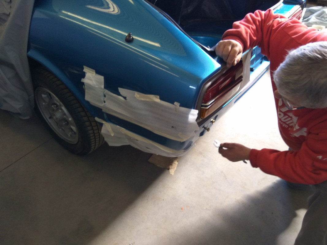

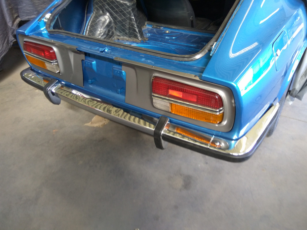

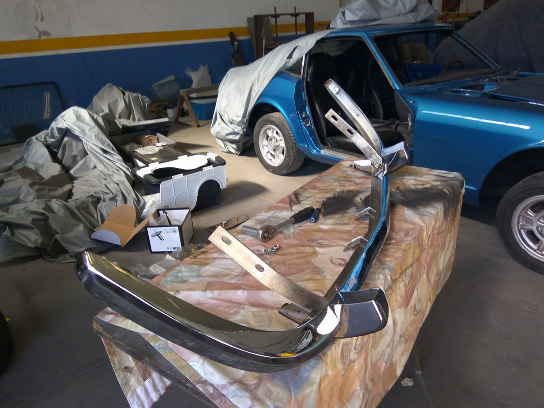

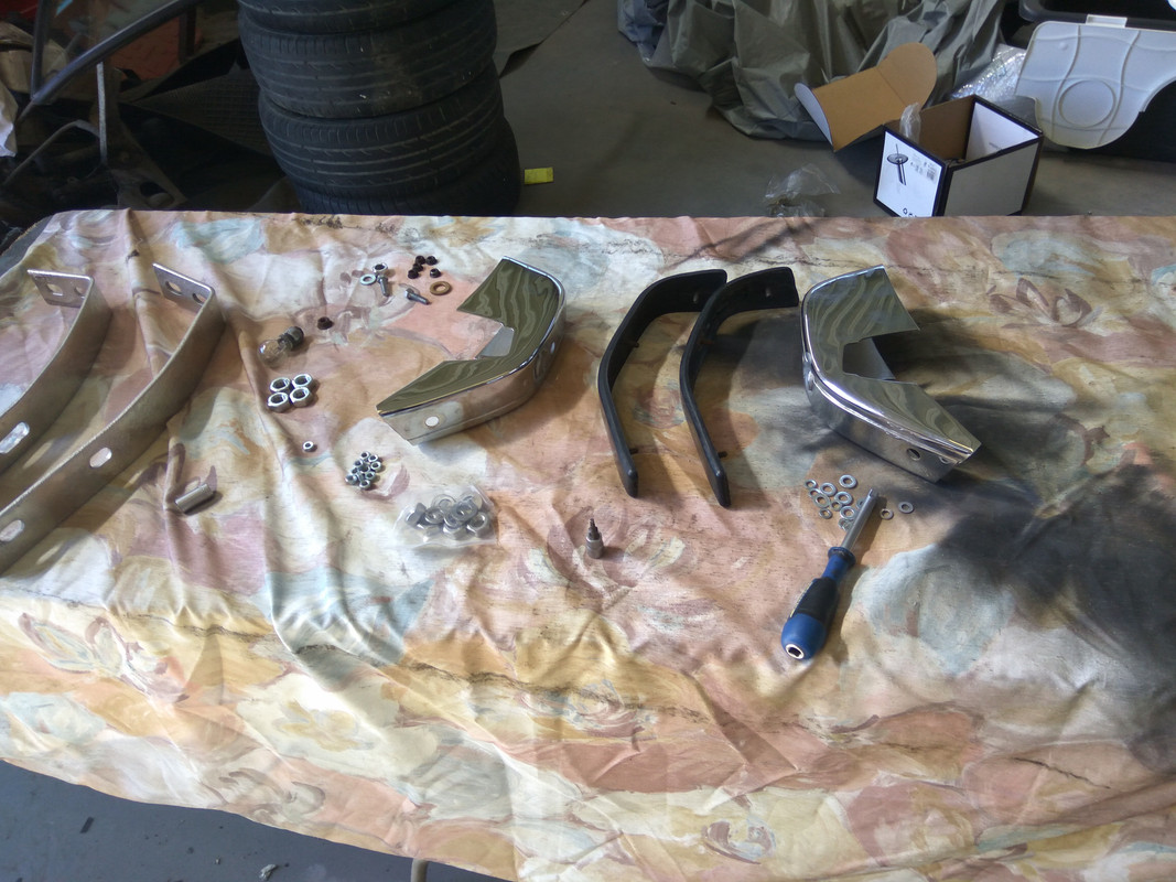

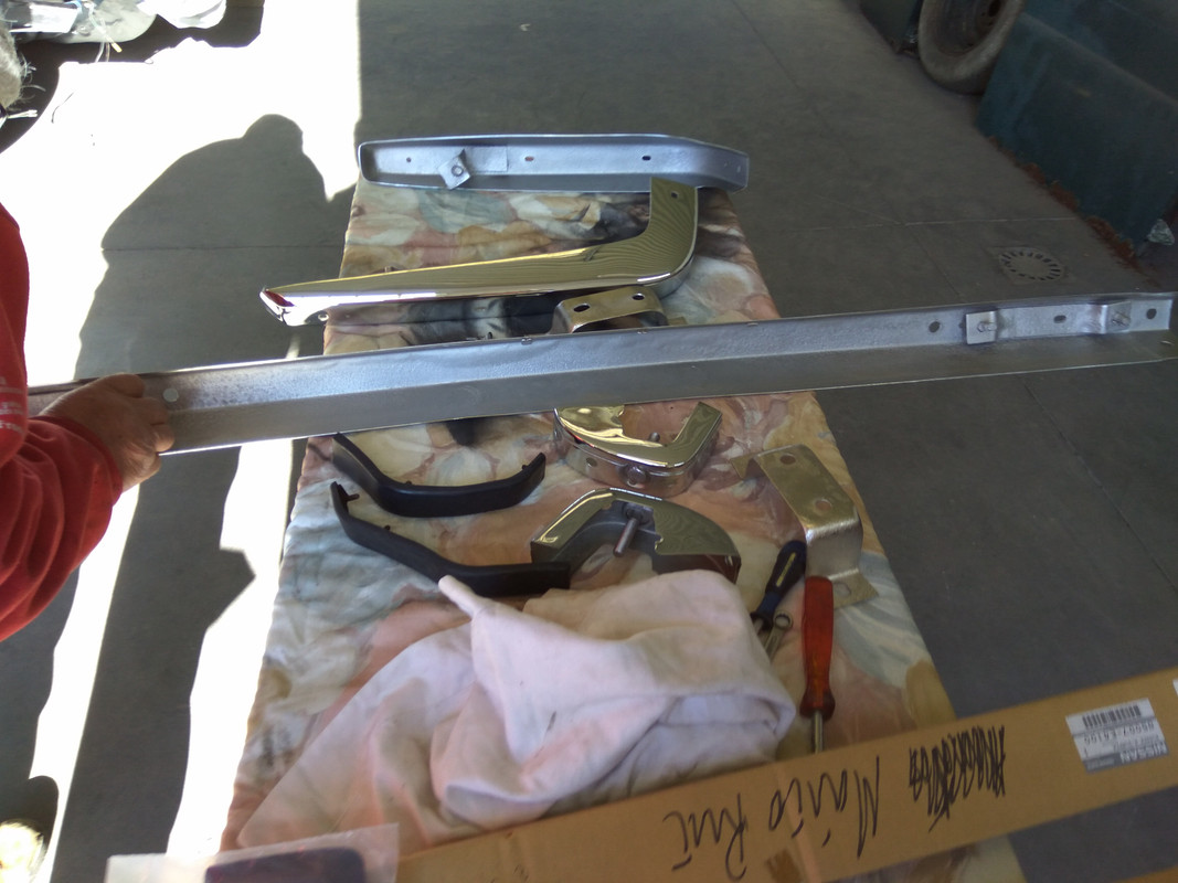

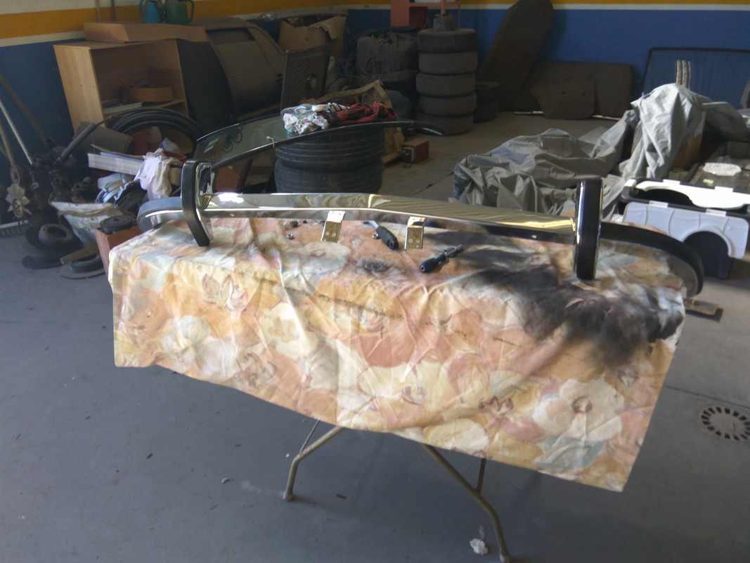

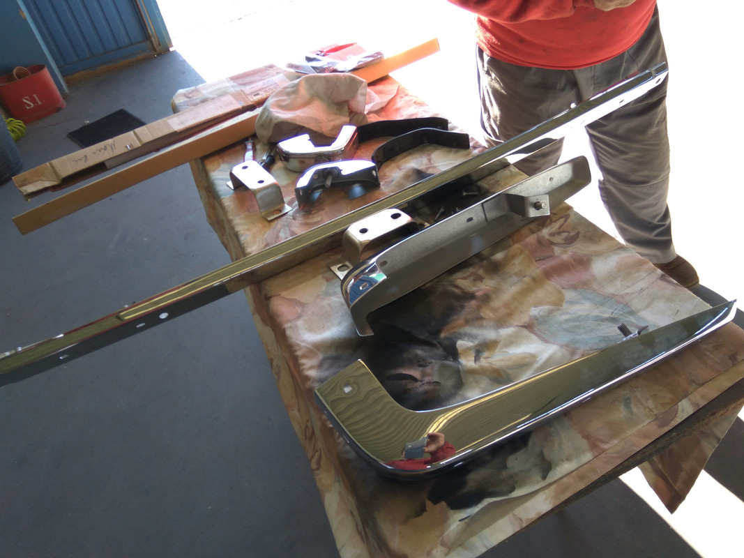

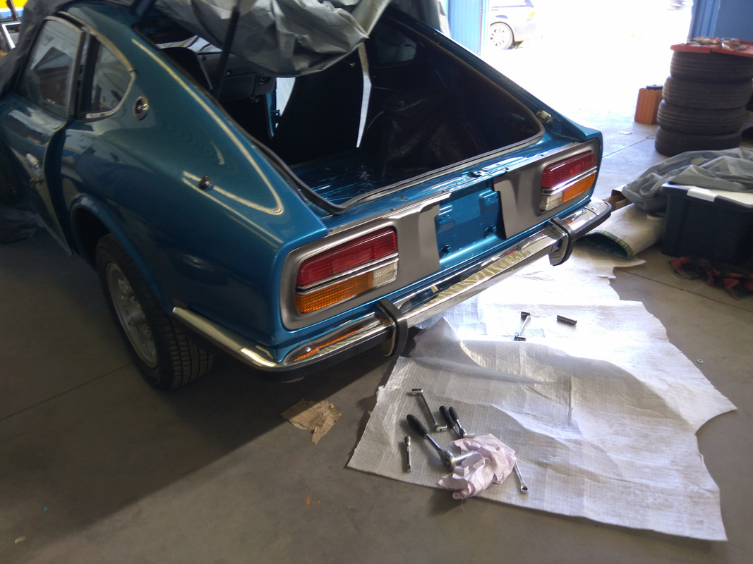

Rear bumper installation! What an enormous task!!! 3 hours until the end!!! Too much parts, rubbers, guards, bolts, tune and so on…luckily everything is original and fitted well!!!

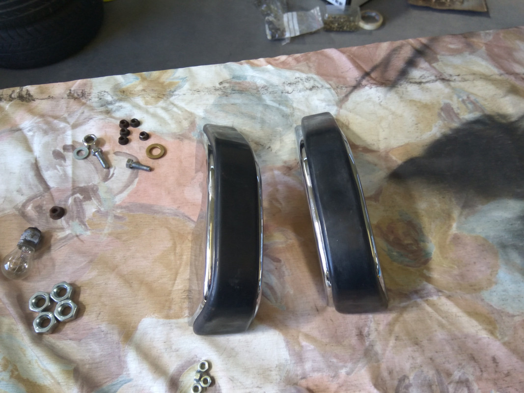

All the new parts…
The result before it goes to the car!
Before the installation we cover the sides with sphincter to avoid some scratches!
Annoying car said Mr.Vitorino...
Almost!!!
And here is the result!!!

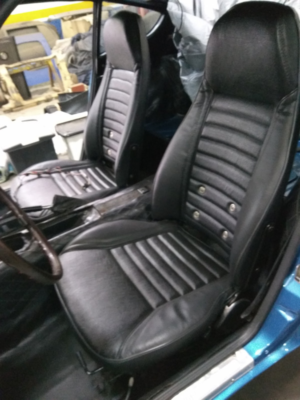

Seat in it’s place…
These were only mounted because Sean Dezart Helped me with the correct parts!!! Thanks a lot!!! I'll have a surprise for you...

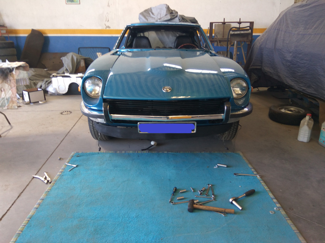

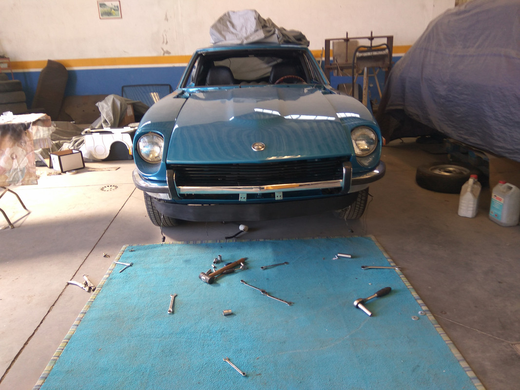

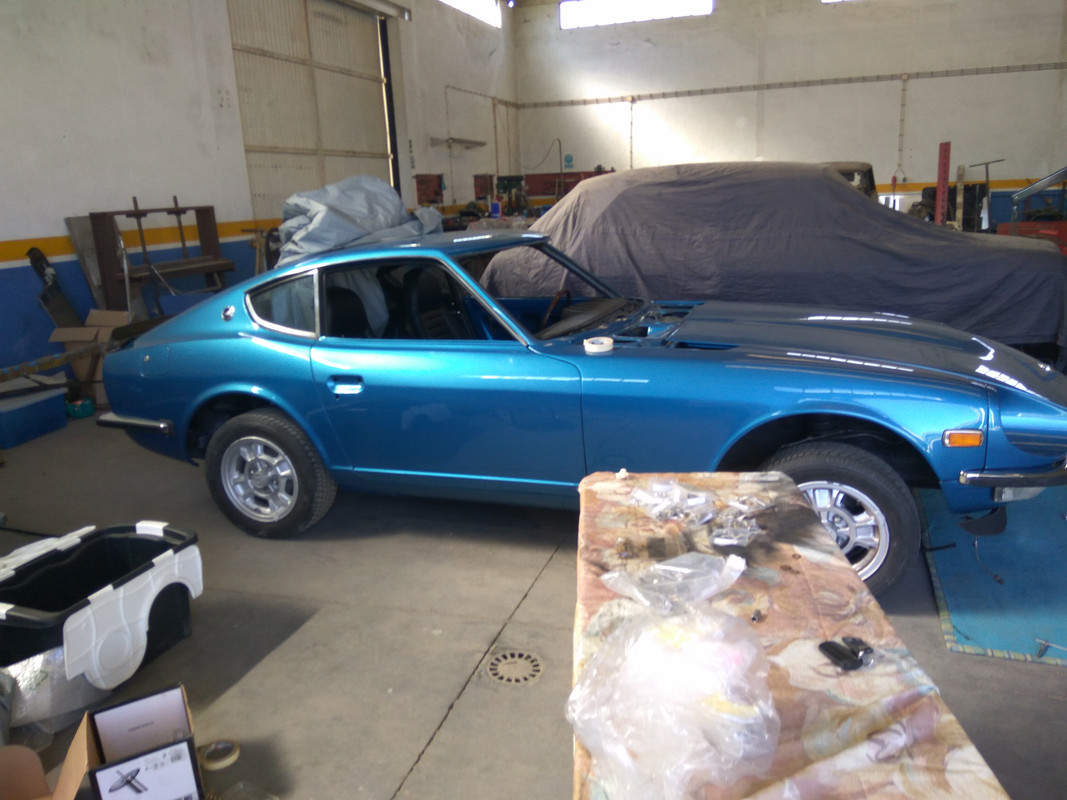

The Z is getting shape!!! And all the weekend was dedicated to it! Now it looks like a Z…I’m very happy with all the results! But it’s a hard car to work!!!Too many bolts and tunning around the parts!

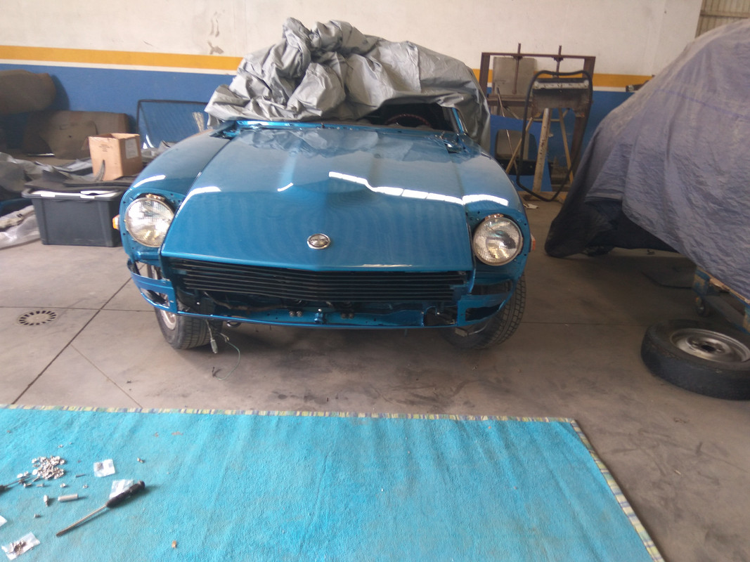

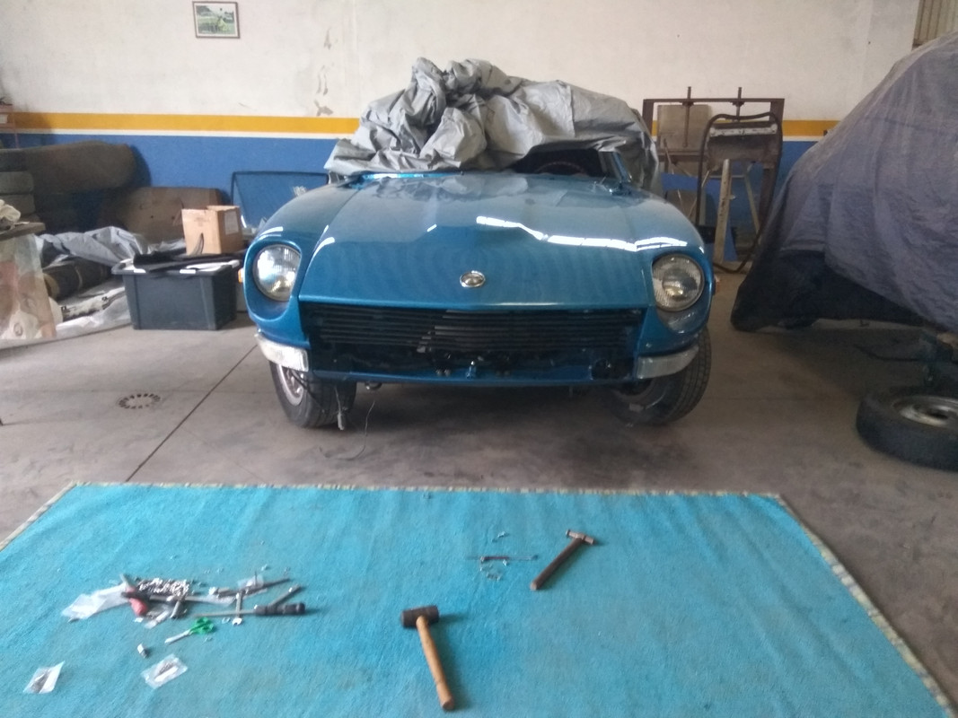

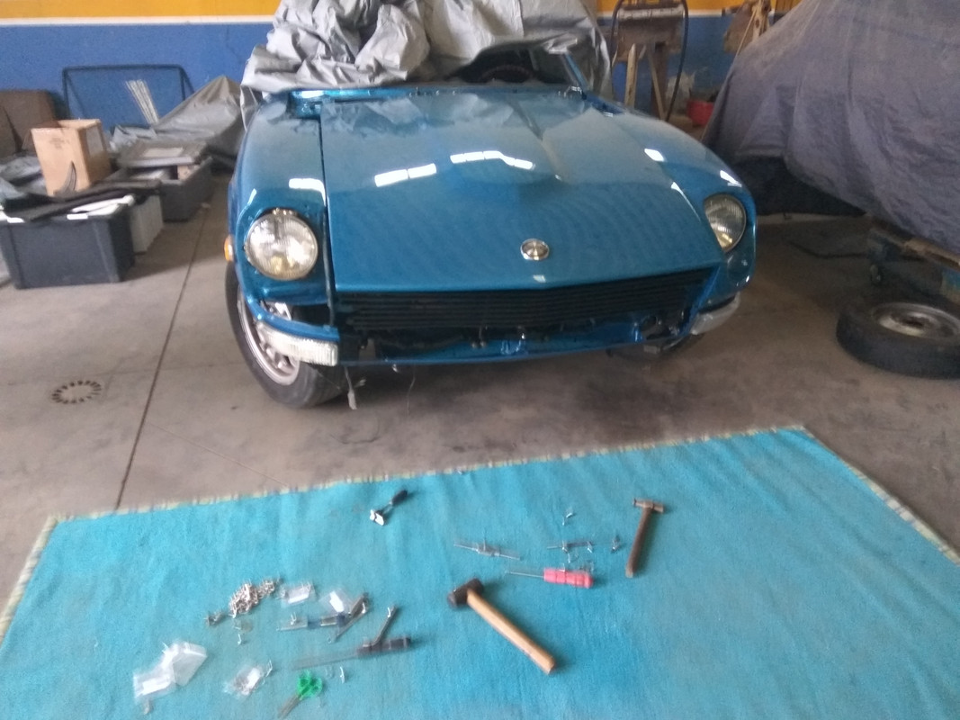

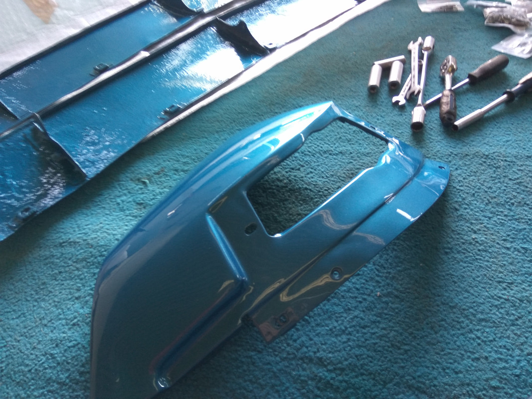

I started with the lower and center valances, then the headlights and finally the surroundings.~

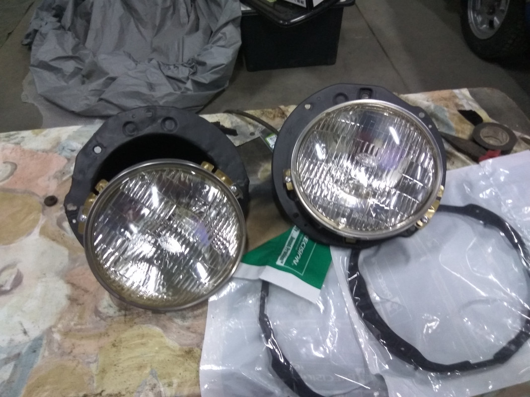

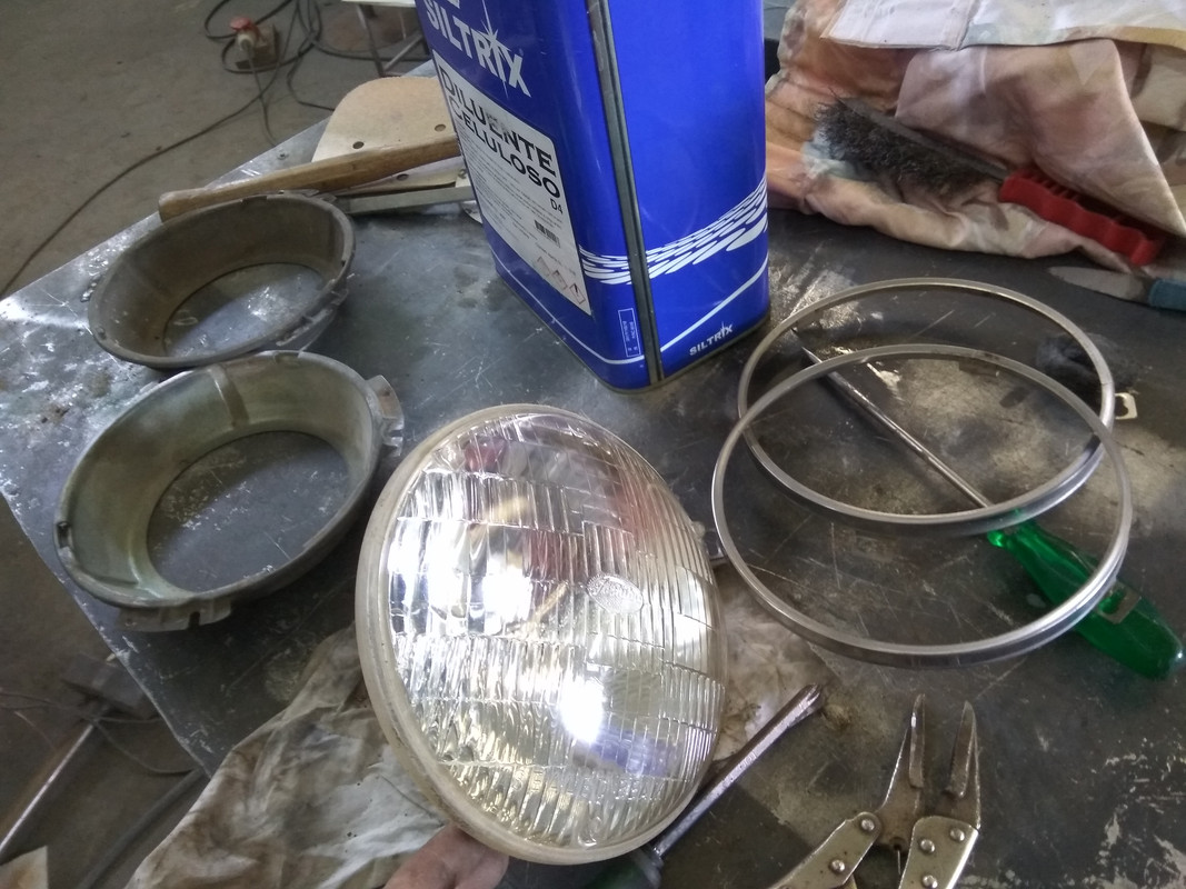

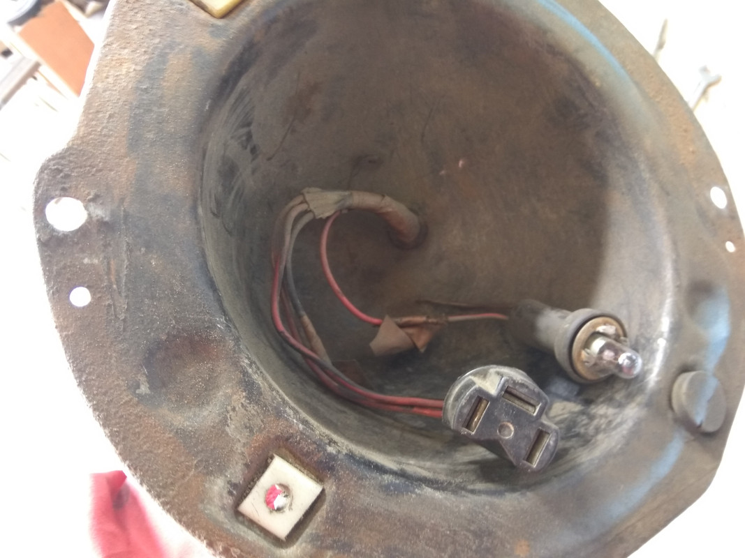

On the lights, my car is from 2/71 and had the 3rd series front, now I’m restoring it to the original shape. Now I placed the original Toshiba headlights and get rid of the wires excess, even the lamps!!! After a deep cleaning all went simple and clear! I’m waiting for the test…

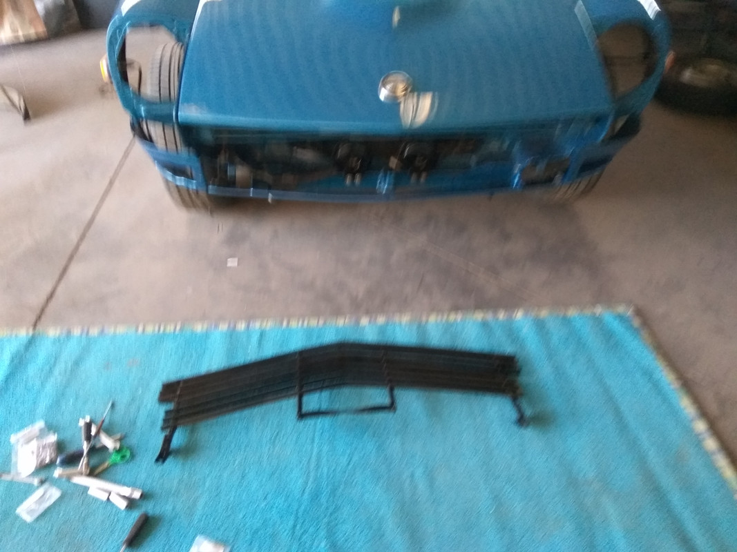

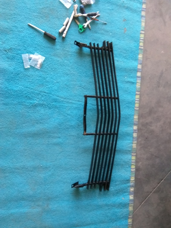

About the grill, I’ll keep the original one, but I don’t know if I will put the 432 instead! But only for the aesthetic reason!

The headlghts…before…
[img]
In the end….
Valances…
Installed…

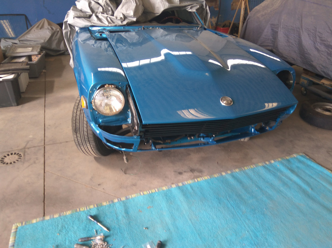

The grill…
Installed….
The headlights...and the gift…

In the end, only the right side of the car needs a hand…only tunning, but it’s a work for Mr.Vitorino…not me!!!

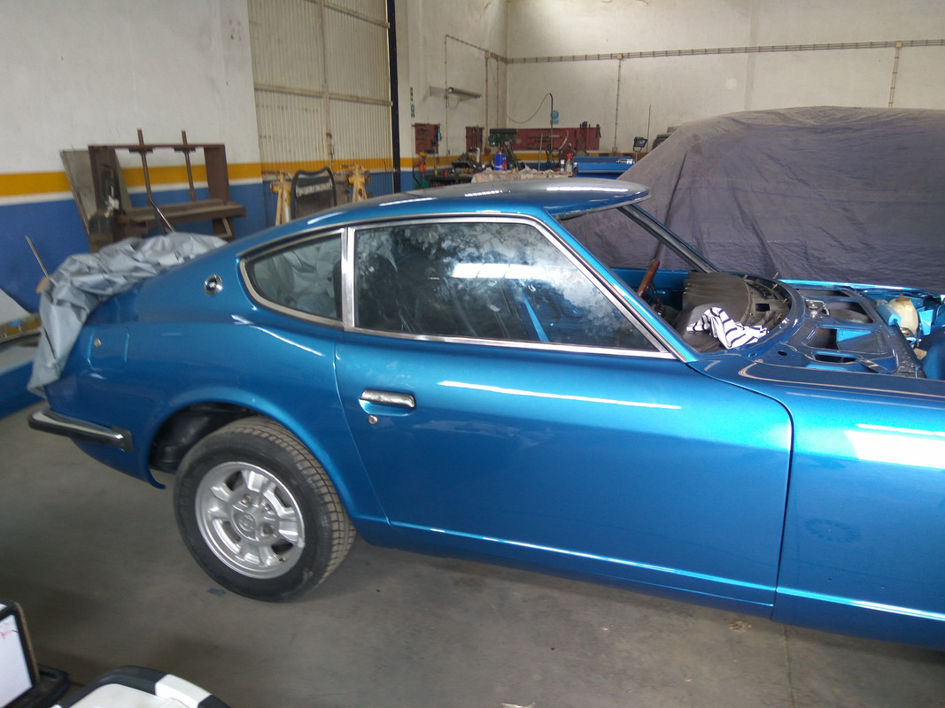

On the past 2 weeks we have done some body work and assemble mostly structures on doors, bumpers and small details.
We had an issue with the front windshield, perhaps I’ve to look for a new one, and on the rear hatch glass in order to avoid problems, I bought a new rubber from Nissan.
The tunning on panels is very hard to do, on my B110 was simple and easy, but not this one…even the locks aren’t closing totally, I don’t know what I’m doing wrong…well…all will be solved…I think!!!
Tomorrow the engine and gear box will be mounted and hope that on Saturday will be running…let’s see. To finish some trouble, the electric system has to be redone too…

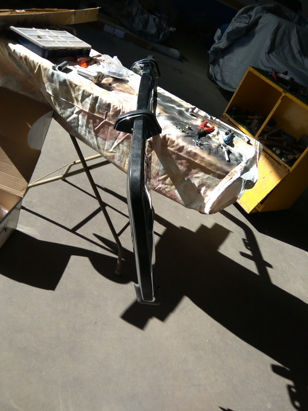

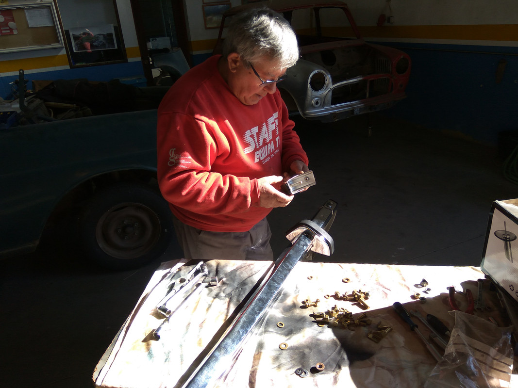

Assembling the bumpers…
Side rubbers.
Schuteons and rubbers.
Ready to fit…
On the car.

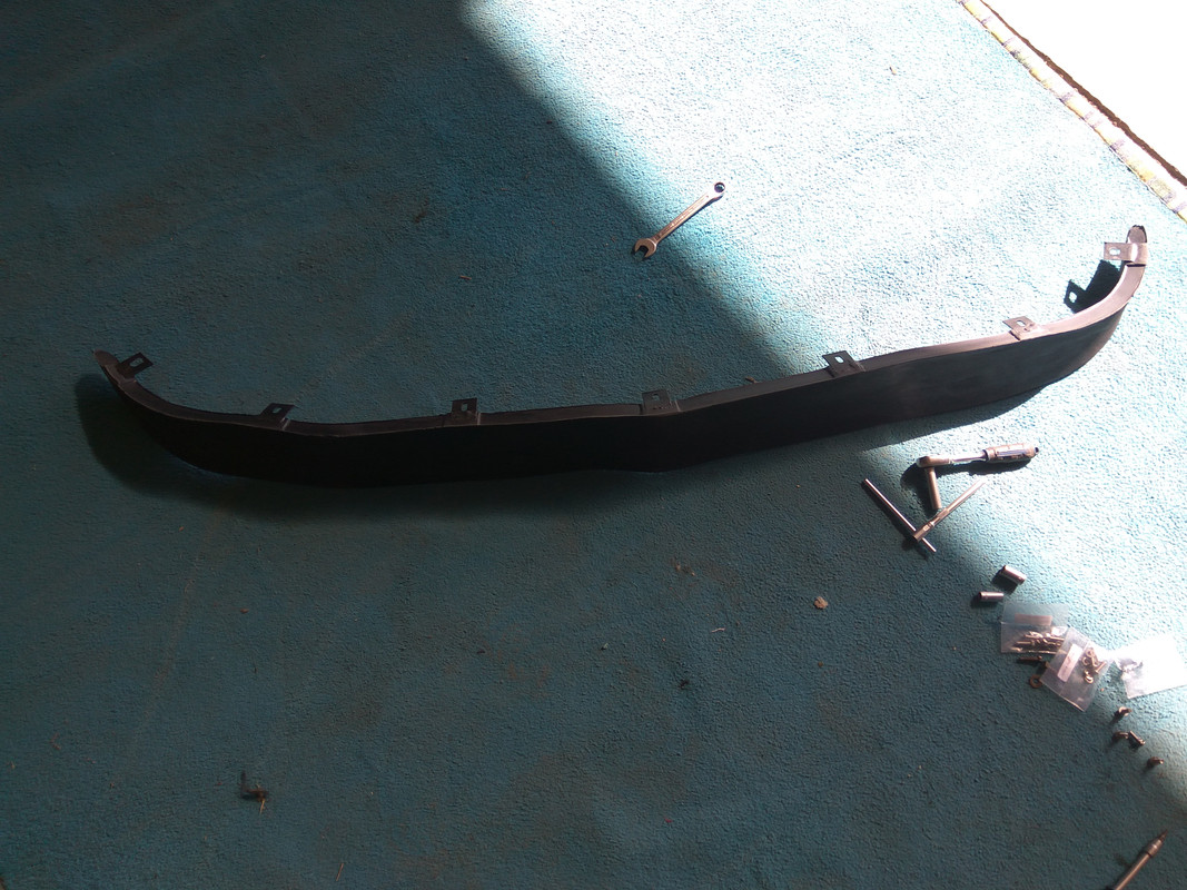

Before we had put in place the front lip.

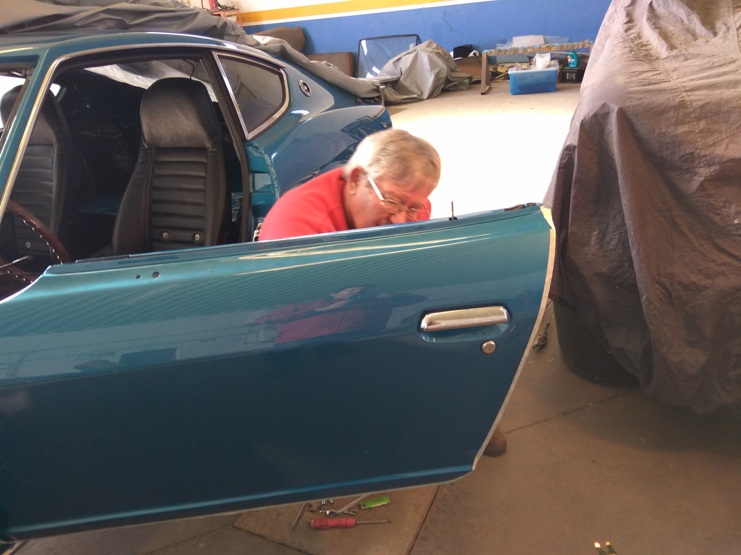

Now the right door….

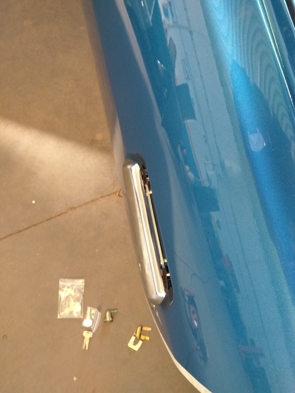

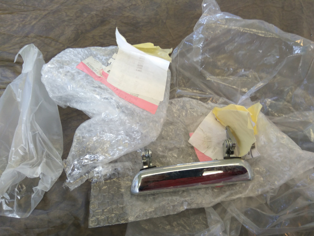

New handles…
Locks and handles…
Before we placed the window some care was took no the top of the doors…
Almos…
And completed with trims…is missing the interior. Maybe next weekend!

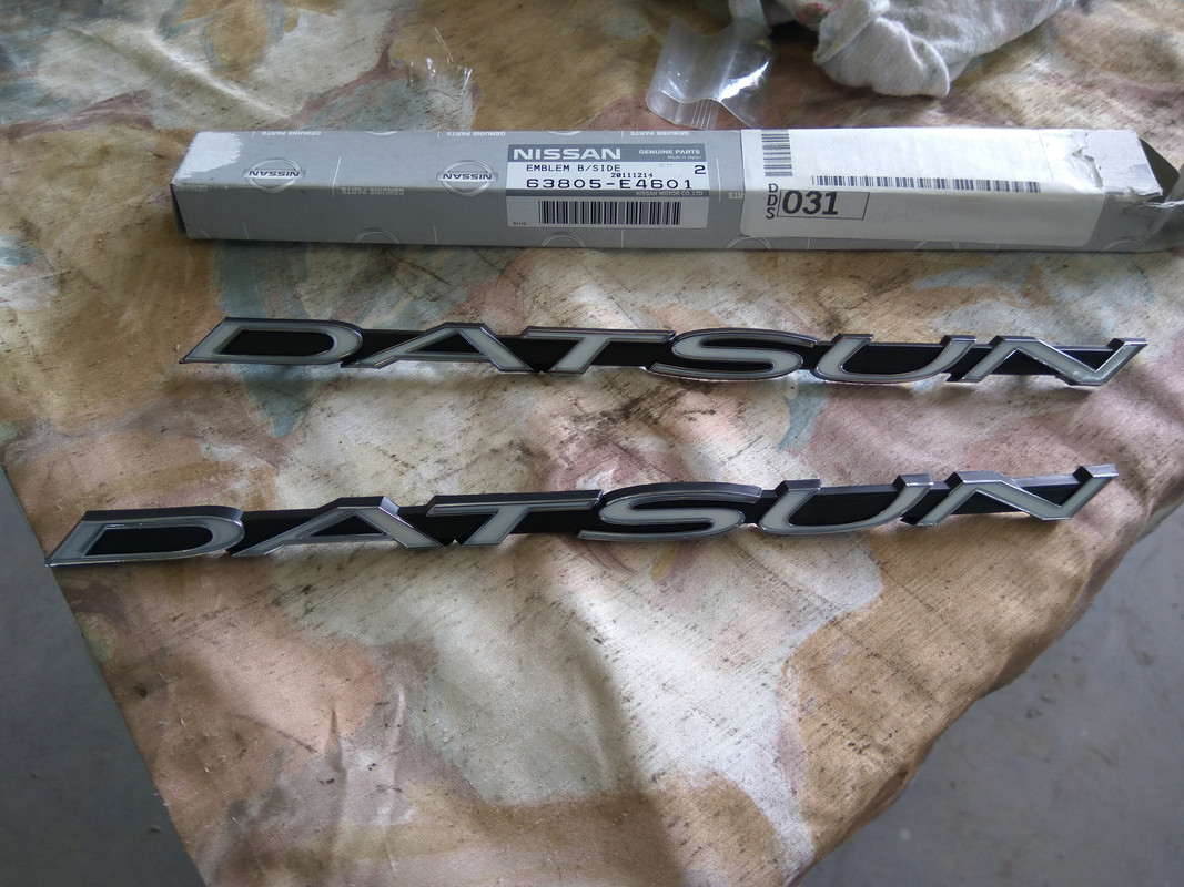

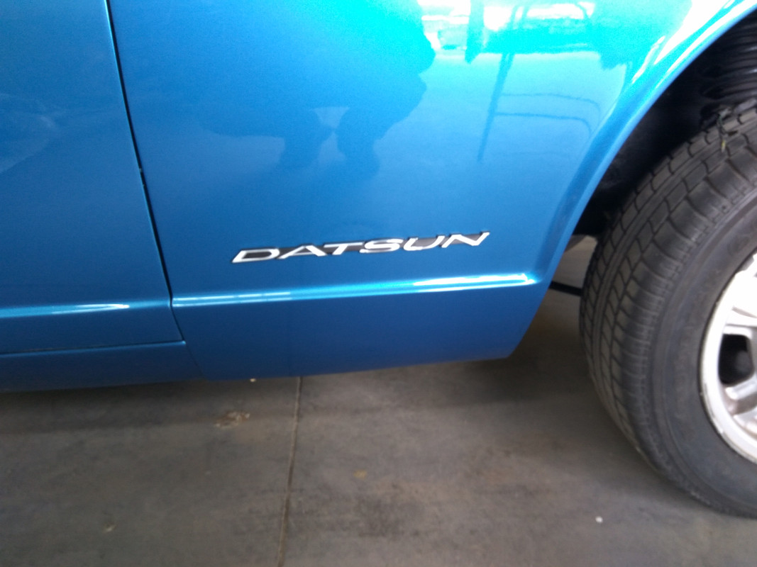

New Datsun symbols on the guards.

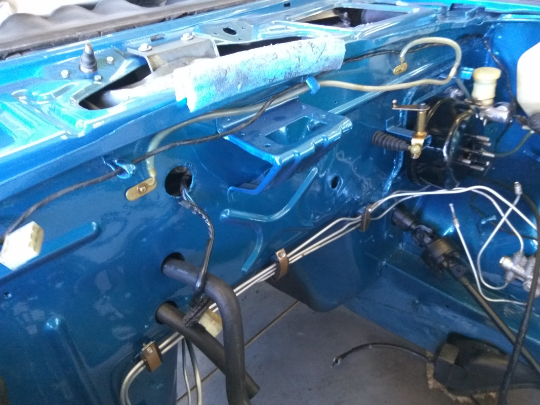

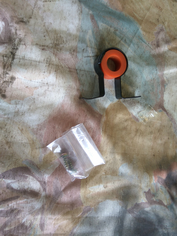

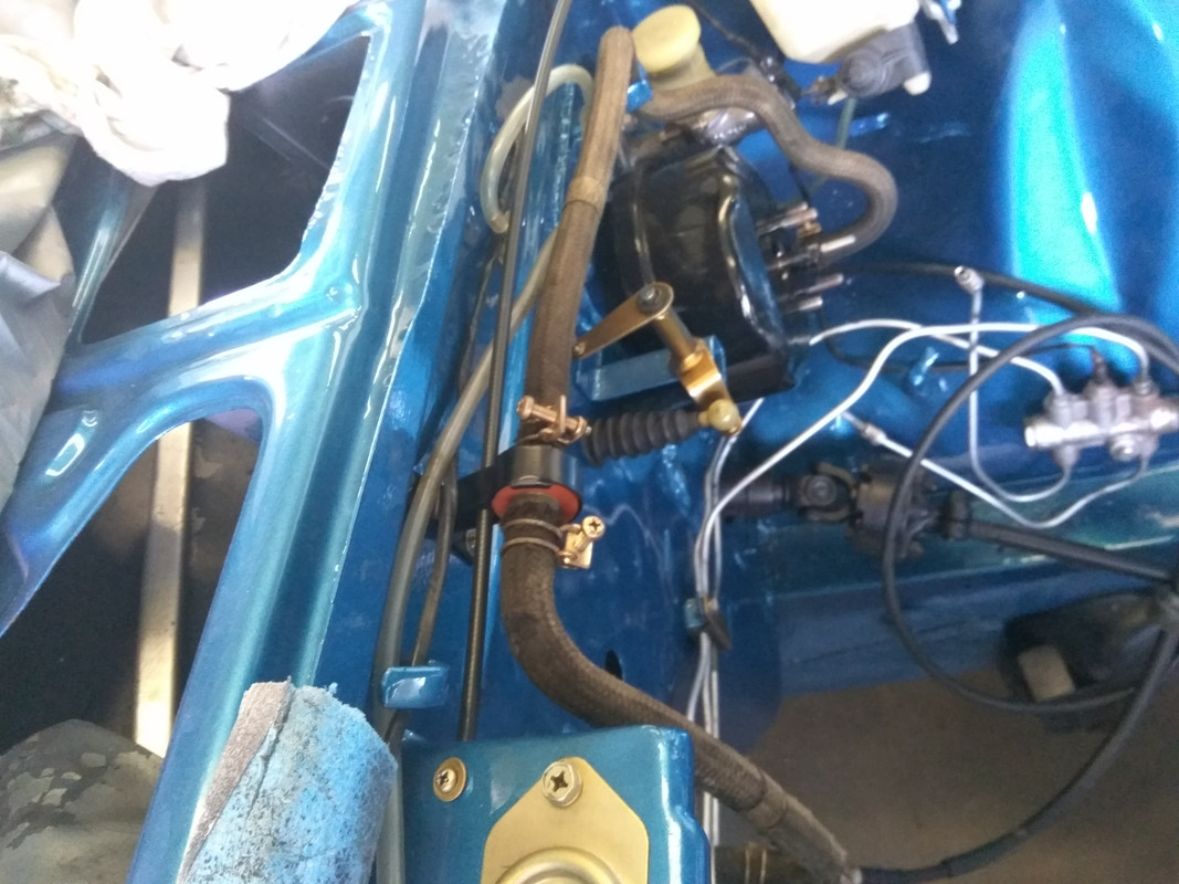

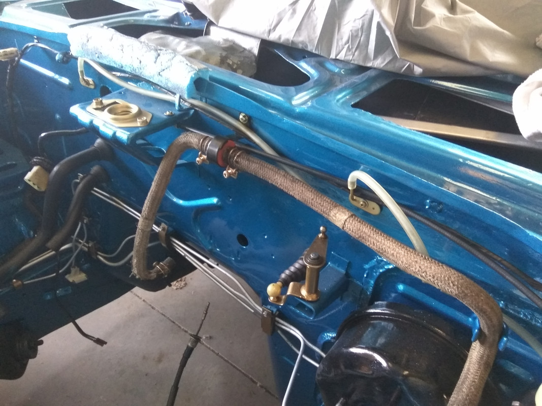

The brakes system had to be revisioned. I stared with the bracket and rubber. My car didn’t have the bracket for the valve, now it’s complete again!
New parts…
Ready to use!

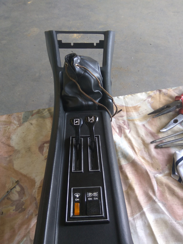

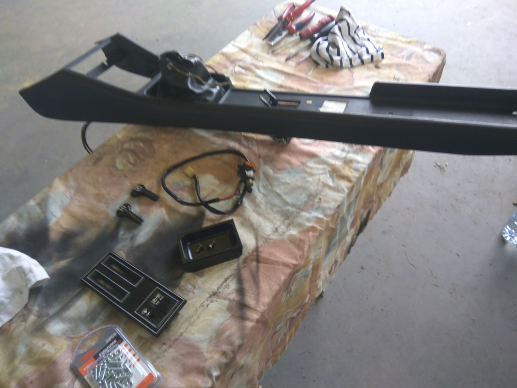

We decided to try the center console because tomorrow will receive the engine.
There is a little issue, I guess easy to solve, my Z had the 3rd series center console, but it wasn’t correct, and when I tried this one, the series ½ the bolts miss the bracket for 4 cm’s. Is the center console small? Something isn’t right for sure, but I’ll try to check what’s going wrong.
